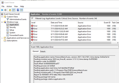

I'm wondering if Event Viewer might show something useful to Esri.  I assume you're already following up with Esri support?  Sample:
Given the issue you're seeing I wonder if there might also be Critical system errors as well?  Might help to pin down which system is faulting.
