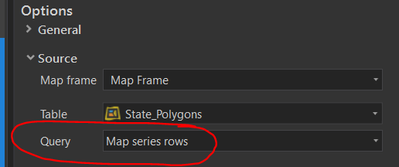

As possible work around: Can you join the index layer with your stand alone table, then set the properties of the table frame to ONLY show 'Map series rows'?  This produces the same effect.
In my simple example, I had State_Polygons joined to Counties_Table (one to many).
