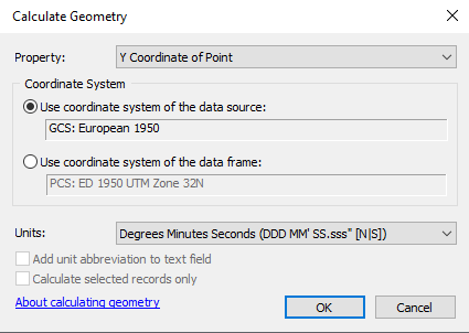

I am observing differences in how ArcGIS Pro calculates geometry/coordinates in DMS (degrees minutes seconds).
The process in ArcMap was very straight forward:

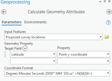

While in ArcGIS Pro, you have to also double check and set the environmental settings:
Now these are the results:
ArcGIS Pro
ArcMap
The seconds are always different. Sure, it is just a couple of seconds but still, why is there a difference in the results of the calculation?
