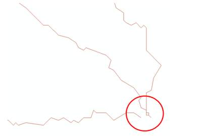

My question: Is there any method to locate the external points of the stream? (I named those points by E in this image)

The features vertices to point is a good idea, but by using it, I will also get the endpoint of all the lines (but I only need the external line)
I tried an idea but it poses me some inaccurate results. My idea was:
  • Find the stream order (Strahler method: the stream should be a raster file)
  • Convert the Strahler raster file to vector
  • Select order 1 from the Strahler vector layer (That will be the external lines only). But at this step, arcgis give me the inaccurate result as you can see on the first attached image (The square for example is 2 more unnecessary vector, so to more unnecessary external nodes)
  • To fix this result, I used to do selection by location (intersect), between the drainage line layer and the Strahler vector layer of order one (obtained in step 3). But unfortunately, the selected items contain some internal vectors. This is why I was saying that I don’t want to use the select by location.
