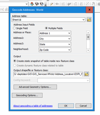

Here is a screenshot of what the parameters looked like for an Excel table I created where I reformatted some of your data.  I added the Street field to a field I called Address 1, City to a City field, State to a State field and Zip to a Zip Code field.
I had 3 addresses from my area in southeast PA plus 2 records from your data in Pittsburgh.  I was able to successfully geocode all the addresses with the ArcGIS World Geocode Service in ArcMap.
