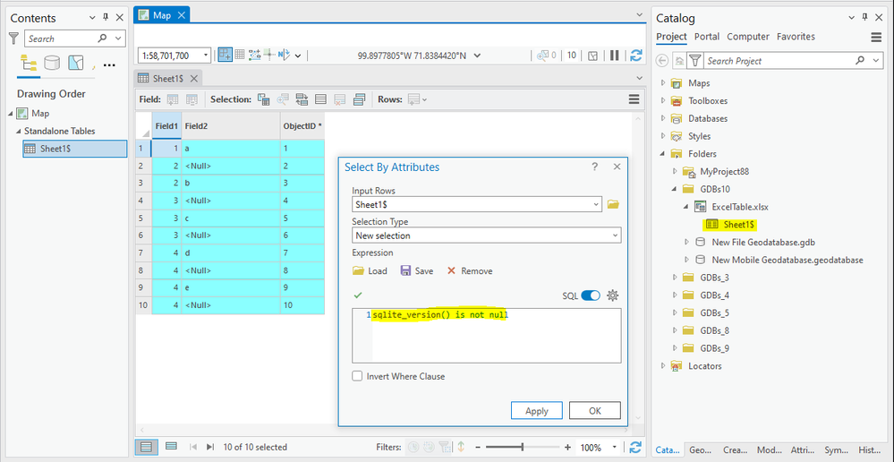

I did a test where I dragged a .xlsx sheet from Catalog into the map. And then did a Select By Attributes using the following SQL expression:
sqlite_version() is not null
It ran without errors and selected all rows.
That SQL expression uses a function that is specific to SQLite: sqlite_version(). Since the expression worked on the .xlsx, and not on other file types like File Geodatabases that use the ArcGIS SQL dialect, then I think that tells us that ArcGIS Pro uses SQLite SQL on .xlsx files.
So the second line in your quoted documentation seems to be correct, and the first line is incorrect.

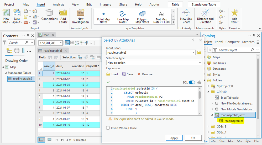

The SQL reference for query expressions used in ArcGIS docs also say:
Subqueries
A subquery is a query nested in another query and is supported by geodatabase data sources only.
I suppose that's not strictly true, since ArcGIS Pro uses SQLite SQL for Excel SQL expressions.
So I'm able to use a subquery (in this case, it's a correlated subquery) in Select by Attributes or a Definition Query on an Excel file. For example, for each ASSET_ID, get the road inspection row that has the latest DATE_. If there is a tie, use the row with the largest CONDITION value.
roadinsptable$.objectid IN (
       SELECT objectid
         FROM roadinsptable$ r2
        WHERE r2.asset_id = roadinsptable$.asset_id
     ORDER BY date_ DESC, condition DESC
        LIMIT 1
Source:
It's strange that Excel spreadsheets (not a database) have more SQL support than file geodatabases in ArcGIS Pro. As we know, FGDBs don't support correlated subqueries.
