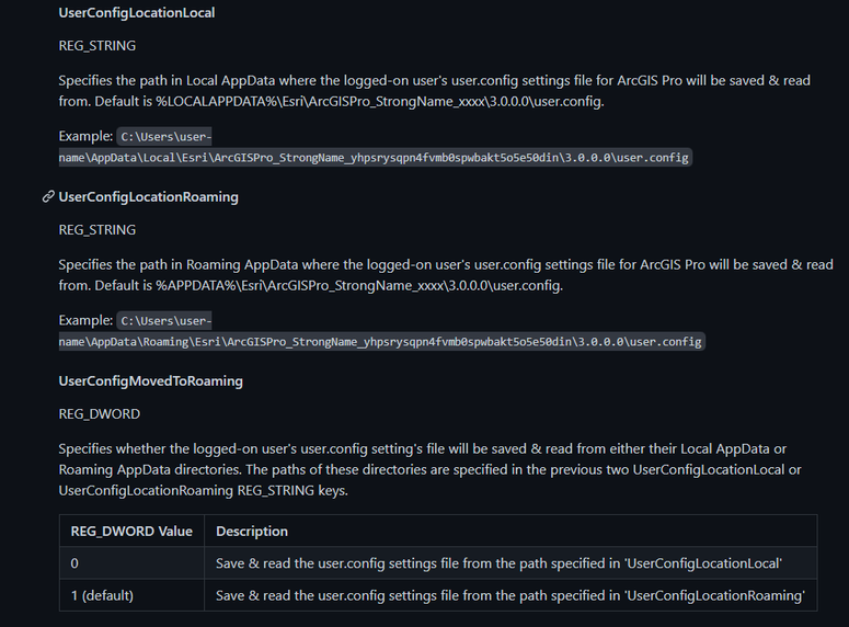

If the answer is yes, I'd ask that you or your IT staff navigate to the following section of your registry in RegEdit: Computer\HKEY_CURRENT_USER\SOFTWARE\ESRI\ArcGISPro\Settings
Once there and at the bottom of the subkey list, you should see the following three subkeys:
An elaboration on what these subkeys are:
For your specific problem, I'd recommend setting UserConfigMovedToRoaming to '0', so that it'll save your user.config in the path specified under UserConfigLocationLocal (which should be on-disk on your machine, ideally) instead of where it's currently being saved under UserConfigLocationRoaming. Making this change isn't going to move any other part of your User Profile locally; it's only changing the save location for your user.config file. As an aside, both UserConfigMovedToRoaming UserConfigLocationLocal can be modified to point to different locations outside of %APPDATA% & %LOCALAPPDATA%, respectively, if the defaults don't suit your needs for whatever reason. That may be pertinent & helpful if your IT staff is also backing up your Local User Profile (or not using it at all) to a network share.
This concern in general is currently encompassed by the following Enhancement & was implemented because of it:
ENH-000137053 - Allow the Specification of a Local or Roaming Profile Installation Option to Avoid Performance Problems Experienced in some Environments After ArcGIS Pro's user.config File was Migrated from Local to Roaming Storage
Although this enhancement is still listed as being Open and/or Under Consideration, it's going to be marked as Implemented in the coming days to point to the solution above that I just described. Regarding documentation for these registry keys, that screenshot I posted above outlining their usage was from an internal page where we're staging these updates - at or before 3.1 Release, they'll be pushed to our public page here to fill the gap: https://github.com/esri/arcgis-pro-sdk/wiki/ArcGIS-Pro-Registry-Keys
