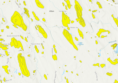

These are just closed contours converted to polygons:
See attached zipped shapefile

Would I be off if I thought you were trying to determine the orientation and perhaps length of those yellow areas?
