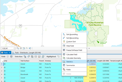

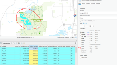

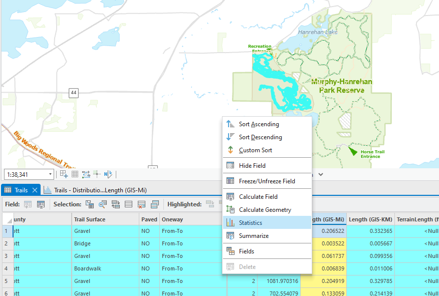

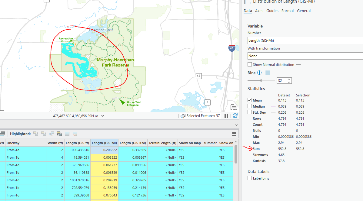

When selecting records then running the Statistics tool, the statistics tool does not respect the record selection and shows statistics for the entire feature layer:
For example the sum of our selection of trails are not 552.8 miles

The Statistics worked fine on my test fgdb layer but failed as in your example when using the equivalent layer from a mobile geodatabase. The Filter: Selection chart option was greyed out in the latter. I saw in another thread where egdb's seemed to have thrown the same problem. It might be related to the format of your data source.
