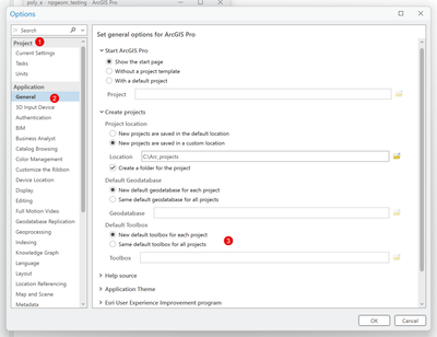

Hello, is there a way I can include a startup python script when I create a new project based on a template?
I want to setup a default toolbox and geodatabase which aren't the defaults assigned by Pro.
Thanks.

You can set a default toolbox, but not a bunch of them unless you specify a specific project to load or a template

Thanks Dan.  I think that could work but I don't really want every new project to use the same geodatabase and toolbox.  At least I think that's what those general settings will do.  I only want to set the defaults on new projects based on this one template.
I can work around the gdbase thing in my scripts I guess.
For some reason my tools aren't coming into the template I create (from the share tab).  ArcPro builds a new empty toolbox based on the new project name.
I'll do some more playing around tmo.  Unfortunately, Pro is taking four hours to build my template file 😞
