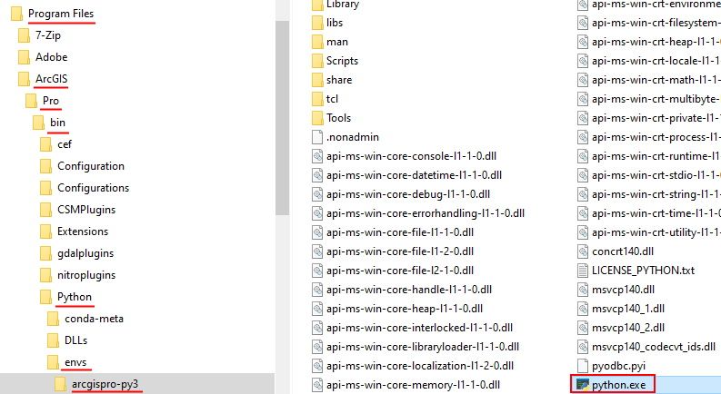

Step 1 - Go to the folder shown in the screenshot below and verify that python.exe is there.
C:\Program Files\ArcGIS\Pro\bin\Python\envs\arcgispro-py3\python.exe
If it is there then:
Step 2 - Paste the following into a batch file and run it:
"C:\Program Files\ArcGIS\Pro\bin\Python\envs\arcgispro-py3\python.exe" "C:\Users\cwafstet\Documents\MODERN GIS WORKING FILES\PYTHON SCRIPTS COLLECTION\CIS DATA GIS UPDATES\CISMIS_ElectricAccounts_ActiveStatus.py"
pause
If you get an error, can you screenshot please.

Tim_McGinnes
pause
ModernElectric
Thank you Tim. That did the trick. Apparently, I had to add the path to the .EXE and the .PY in quotes. That is why it was not running.
