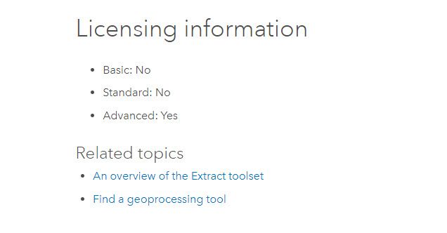

Hi,
In helping a coworker we realized the split tool in ArcGIS Pro now requires an advanced license? Is this an error? I know this was not the case too long ago because a number of the people I work with are using the basic license.
Split tool is such a basic geoprocessing tool and I'm hoping this was not purposeful.
Thanks,
Kathy

That split tool is in the analysis toolset
Split (Analysis)—ArcGIS Pro | Documentation
there are many other ways to split features that don't require that tool.
Are they/you sure that it didn't require an advanced license? and if so what version? since advanced is listed as far back as 3.0

kmsmikrud
Thanks Dan! You reminded me in our group we typically use the split tool (Split a feature) in the editing tools rather than the Split (Analysis) tool. Which actually is interesting since the split a feature works with basic license.
https://pro.arcgis.com/en/pro-app/3.2/help/editing/split-a-feature.htm
Thanks for the reply!
