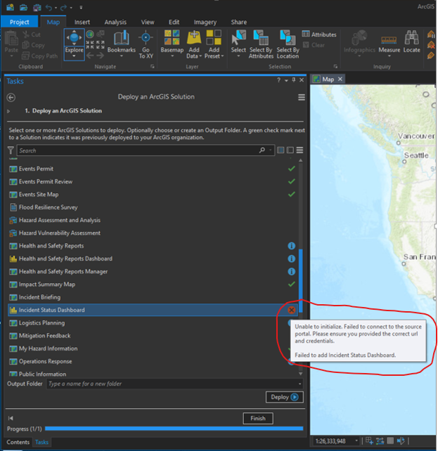

I have been having problems with the solution deployment tool where I get an error saying it "Unable to Initialize. Failed to connect to source portal". The solution I was trying to deploy was the Incident Status Dashboard but I get the message on all solutions and switching to different ArcGIS online accounts does not solve the error.
I did some troubleshooting by upgrading Pro to 2.3.2 and updated the deployment tool to version 2019.3.19 on Windows 10 but the issue has not gone away.
Does anyone know what might be causing the error?
Error in solution deployment tool
Thanks Brady
