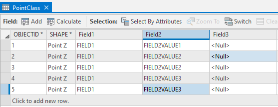

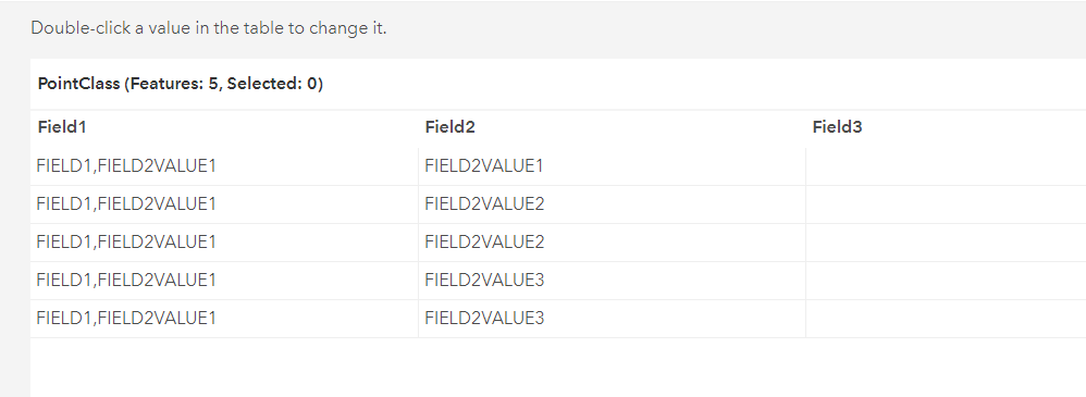

When I share a featureclass (share as a web layer) with ArcGIS Pro (2.7) to ArcGIS online, the data is not correct in ArcGIS Online. The featureclass is symbolized with the option “Unique values” and I have select two fields (Field1 and Field2). The data in Pro is ProblemPicture1 and the data ArcGIS Online is ProblemPicture2. As you see the values in Field1 are not the same as in ArcGIS Pro. Is this a bug?ProblemPicture1.PNGProblemPicture1.PNGProblemPicture2.PNGProblemPicture2.PNG

Yes, the first time when I saw the problem I though the data is not good. So I start a total new project and add a Featureclass, set the symbology and add some dummy records. Just for testing of the problem also occurs when I create a simple featureclass (see the pictures). Could you reproduce the problem in your Arcgis environment?

If you add the web layer to Pro and examine the attribute table, do the fields appear correctly there?
Jonah
JosZwambach1
When I add the web layer to Pro then the data appear correctly.
