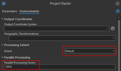

Hello @BrianBehan,
I don't know if you are configuring environments but I believe you could improve those numbers at least on Project Raster and Contours (SA) tools which allow paralell processing (also set the extent to the layer you are trying to project/make countours).
Hillshade on the other side does not allow pararell processing.
