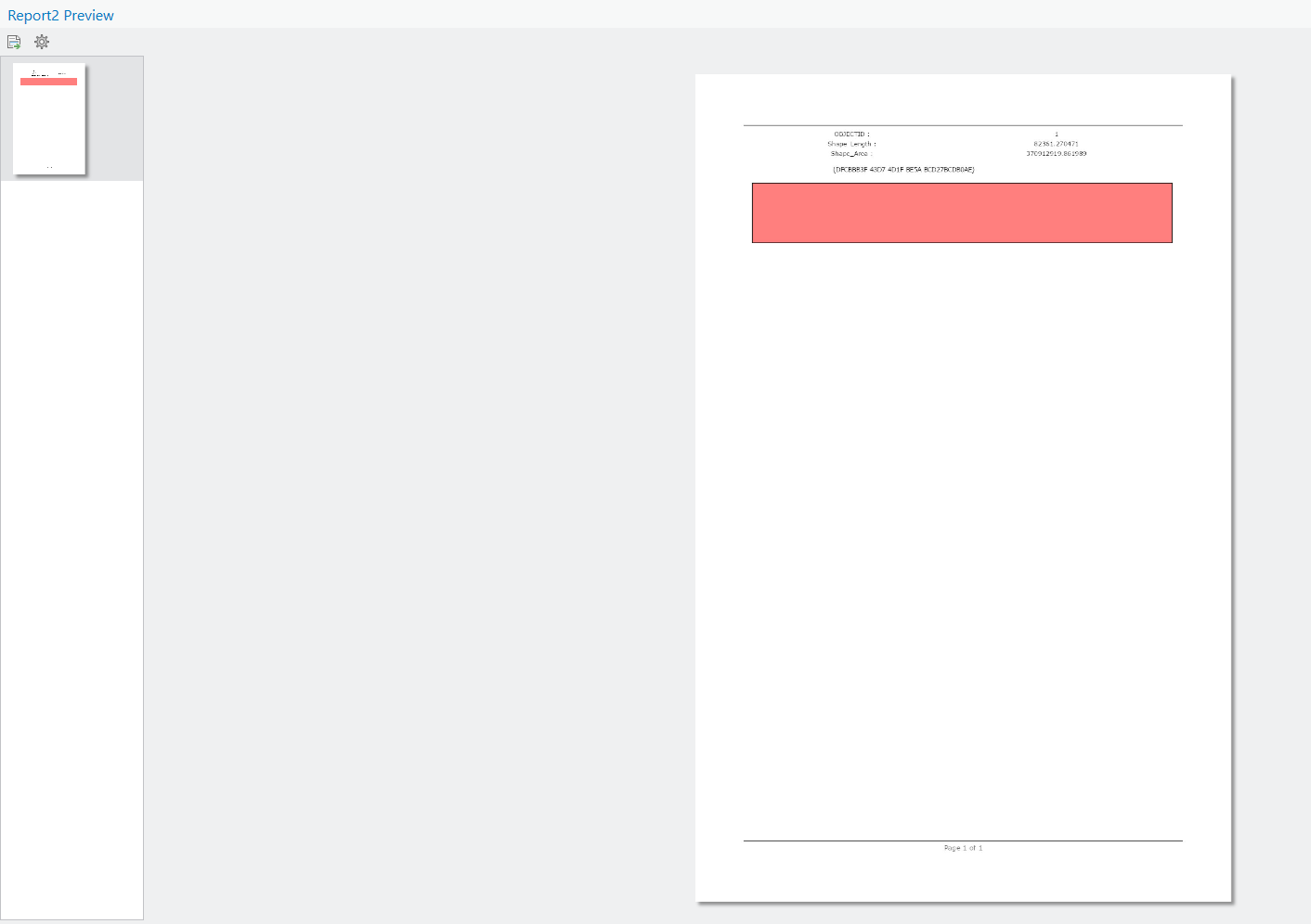

Hello, I am trying to use the report feature in ArcGIS Pro 3.7.1. However, I cant seem to get attachments to get any attachments to show up. The attachment pane seems to be always blank. I tested with differnt databases and image types.
Any solutions out there?

If you're working with a local gdb, it's been documented and should be solved in 3.8 (https://support.esri.com/en-us/bug/attachment-frames-in-arcgis-pro-reports-do-not-render-i-bug-00018...).
Have you tried and compared with a feature layer service?
