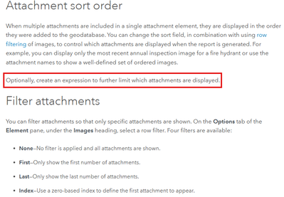

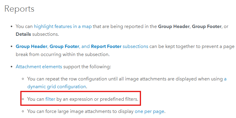

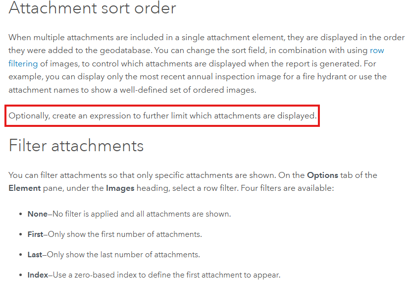

Both the ArcGIS Pro 3.7 "What's New" and the ArcGIS Pro Report Elements documentations mention that filtering attachments on a report through an expression is now possible on the attachments element, however, I do not see this option on my 3.7.1 Pro. I see the row filter options, but no option to create an expression. Am I missing something or this functionality is not available?
EDIT: After further testing I found that the option is not present when creating a report for a feature layer service, but when created for a local feature class or table, is is present. Looks like a bug
See:
https://doc.esri.com/en/arcgis-pro/latest/get-started/whats-new-in-arcgis-pro.html
https://doc.esri.com/en/arcgis-pro/latest/help/reports/attachment-report-elements.html#include-attac...
