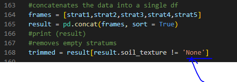

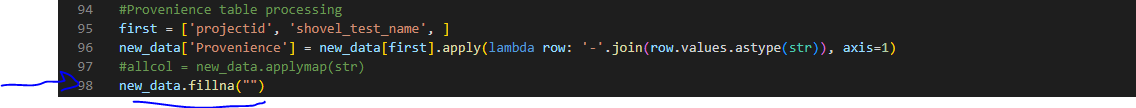

After much discussion internally, we believe that the error is coming from an outdated Pandas function. We believe we have identified where two chunks of code that are potentially outdated:
This is our best guess at finding the error location(s), but it is definitely possible that we are wrong about that. This python debugging effort is unfortunately beyond the skill level any of us have using python. If anyone has any ideas as to how to potentially revise these few lines, that would be greatly appreciated!
Thank you,
ZenMasterZeke
The error should give you the line number where it occurred in the traceback section. There are a few different ways to debug and/or use try/except structures, but if you're not up on those, try uncommenting the print(result) line so you can examine the dataframe. Either set a breakpoint, send result to an excel or csv file or comment out following lines so you can see what values you have that might be raising the error.
