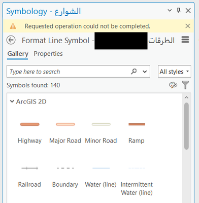

The issue persists in AGP 3..3.1 it is a show stopper to work with complex symbology for polyline layers. we are not able to move forward with such behavior. it is noted, the issue faced when using a feature class stored in file geodatabase and enterprise geodatabase.

I solved this issue by using unique value symbology with auto-generation (list all values) and then changing the symbol for each value separately. that's worked for me.
SierraDymond-Smith
Hi, I tried this and it allowed me to change the color of my lines if they are single layer symbol but not if they are more than one layer. The moment I try to add another layer to the symbol I get the same error. Did this happen for you as well?
