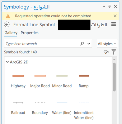

ArcGIS Pro: Polyline Symbology error: "Requested operation could not be completed"
6102
14
07-12-2024 12:04 AM
ElieRizk
The issue persists in AGP 3..3.1 it is a show stopper to work with complex symbology for polyline layers. we are not able to move forward with such behavior. it is noted, the issue faced when using a feature class stored in file geodatabase and enterprise geodatabase.
we tried the steps mentioned in the following ESRI technical support page without success.https://support.esri.com/en-us/knowledge-base/error-requested-operation-could-not-be-completed-00002...
Also, someone mentioned that ESRI categorized this issue as a bug, but we aren't able to find the bug number.
"@ABishop kindly can you head up to the number of the bug mentioned in the URL you inserted in your message?
Here is a link to the BUG report site: https://support.esri.com/en/Search-Results#search?q=arcgis-pro&content-type=Bugs"
thank you,
ER,

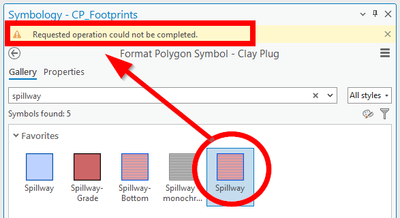

I can confirm this same behaviout with lines but It's also happening with polygons.  I don't seem to be able to modify or add composite symbols in an existing pre v3.3.1 layer. (anything composed of more than the 2 default symbol layers). The only solution seems to be to add the layer into the map and build new symbology from scratch. When I get the "Requested operation could not be completed" warning, i am not able to same the symbol or layer symbology.
