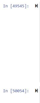

Hello,
I'm encountering a phenomena that I haven't seen before.  While running Notebook, the cell counts are extremely high and non-sequential.  This leads me to think there are processes running in the background ticking up the cell count, and eating memory, but not really sure.  Additionally ArcGIS Pro has been extremely slow especially when Notebook is running.
The image below shows the first two cells of a particular notebook executed in order within seconds of opening and seconds apart.
Any ideas about what is going on and how to mitigate?
Thank you,
Tyler

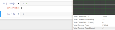

That seems extremely strange. Can you open the ArcGIS Monitor (Ctrl + Alt + M) to see what tasks are running?

I didn't have Pro open at the time, and forgot the name of it. It's the Diagnostic Monitor. Just do Ctrl + Alt + M and take a look at the Tasks tab.

So, interesting stats.  The Total CIM Writes-GUI is continually ticking upward with no input by me.  Additionally the Cell Count approximately matches the Total CIM Writes-GUI.  The image below shows the output cell followed shortly after by a screen shot giving a bit of time to tick up Total CIM Writes-GUI higher.  This project was open for less than a few minutes.

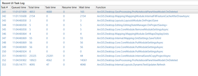

And here are list of task that seem to re-appear after a clear and a cell run, and waiting for a bit.  The top two tasks show up immediately after the cell run, and all the other tasks show up after the autosave.
