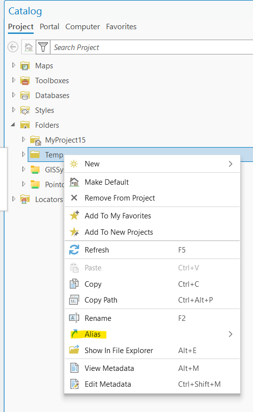

Hi All, we just upgraded to Pro 3.7 but have noticed the ability to create an alias for a Network Folder Location in the catalog is no longer possible, I'm not sure when this change happened, as I have checked a Pro 3.6 install and that is the same. Going further back to Pro 3.3, I can change/set an alias for a network folder. If you are using a local folder, the ability to set an alias is unchanged in all these versions.
Is anyone else noticing this? If so, wonder if it was an intentional change?
Network folder context menuNetwork folder context menulocal folder context menulocal folder context menu

Interesting, I just looked at another VM I have that had Pro 3.4 installed. Confirmed alias worked for a network folder location (\\server\ShareFolder, I then ran the updater in the app to go to 3.7. Once that finished, I opened the same project again and the ability create an alias for the same network folder was gone.
I then discovered if I went one folder deeper \\server\ShareFolder\SubFolder - the sub folder would allow me to change an alias. I wonder if Pro is recognising that folder is the root of a share and so behaves differently -it also has the folder icon with the green bit at the bottom?  We also have some DFS shares accessed by \\domain\share$\GISShare which are fine.
