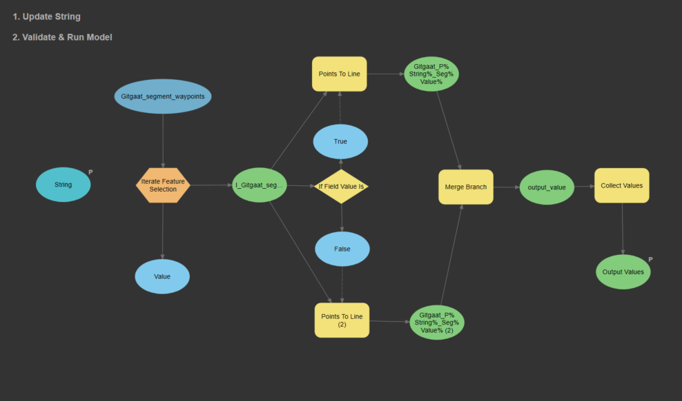

I created a model using Iterate Feature Selection. For each feature selection I use 'If Field Value is' to determine how my points are converted into a line, I then merge these two branches, and collect all the values.
I would like to use this model as a submodel, so that these Output Values can be the input for my next process. However, the model only works in edit mode. When I run this model as a tool (Stand alone or within another model) the feature class from the last iteration is not saved.

Ever figure this out.  Iterate Features only works in model builder for me but not when executed as a tool.
NoahEnverus
In the same boat. Would love a reasoning or a solution, ESRI. can execute as a tool just fine, but not saving the Last/ Only (if there is just one in the file.gdb) is a real issue! any help would be appreciated.
