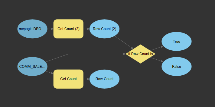

I am working in ArcGIS Pro 2.8.2.  I want to build a model to get the counts on two different sets of data (one being a feature class in SDE and the other being a shapefile), then compare those two counts and if they match, do nothing, if they don't match send me an email so I can check out the issue.
So far I have the following model started.  Any help or direction on this would be greatly appreciated!

I think <> might be deprecated at the Pro version of python as I am much more familiar with the older ArcMap version of python.
Try != instead and see if that corrects the error.
I would also print the actual Row_Count values to make sure the value is what you expect.  Remember to convert numeric value to a string.

Thank you to @MichaelVolz for assisting me with this!
In case anyone reads this thread later and wants to know the final code that worked:
