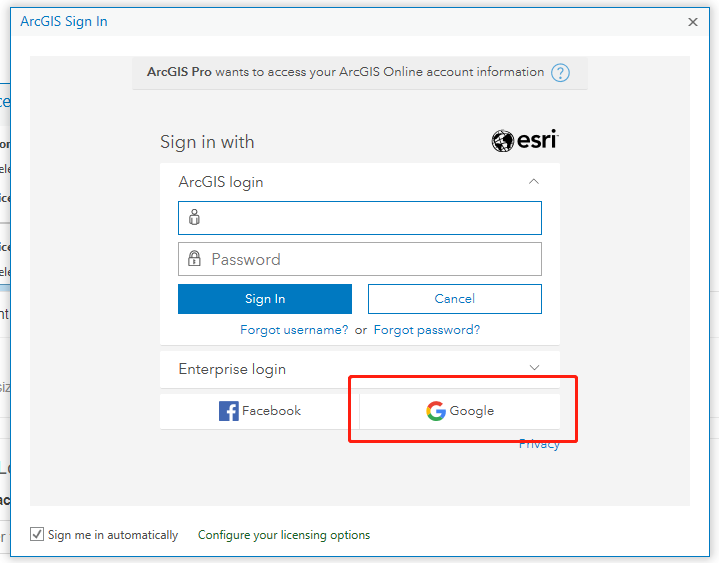

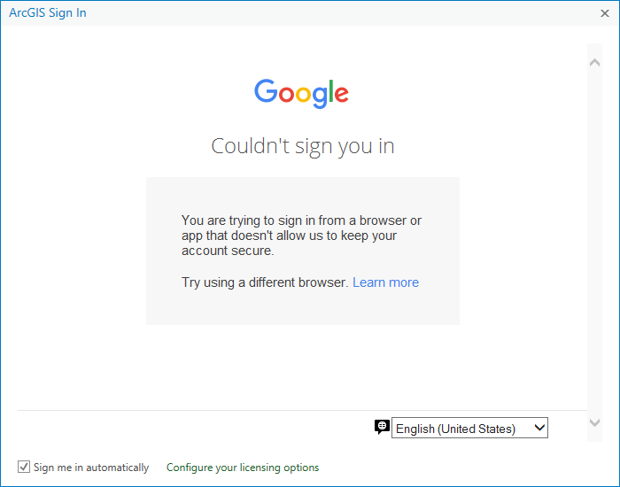

I downloaded Arcgis pro in my account, and installed it. I signed up with my Google account for login. I clicked google and input ID and Passwords, and warning window was popped up. Even if click "yes" or "no", show google wanrning page, and says:" Couldn't sign you in, You are trying to sign in from a browser or app that doesn't allow us to keep your account secure. Try using a different browser. Learn more" I can't log in.

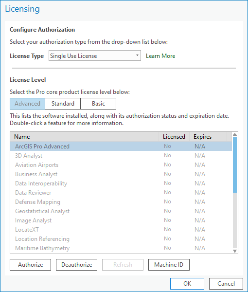

I try to authorize my program using Authorization number. I finished it, but it's not working...
license is in computer, but nothing is activated..

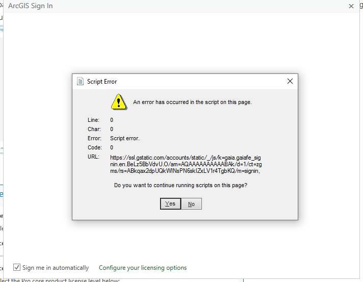

1.  Did you create an ArcGIS Online organization?  This must be completed first.  The following documentation will walk you through the process if have not done so:  Set up an ArcGIS Online organization—ArcGIS Pro | Documentation.  If you did already, were you able to log in using the account from the organization without going through Google?  If you have not, it doesn't matter if you resolve the scripting error you've mentioned.  The account must first be assigned an ArcGIS Pro license.
2.  If you open IE on your machine and go to www.google.com and attempt to log in, do you get the same script error?  If so, this is an issue with the web browser not working with Google's login dialogue.  This is an issue outside of ArcGIS Pro.  I suggest searching the Internet for a solution or contact your IT staff can help with this.  Once this is resolved, Pro should allow you to log in with your Google account.

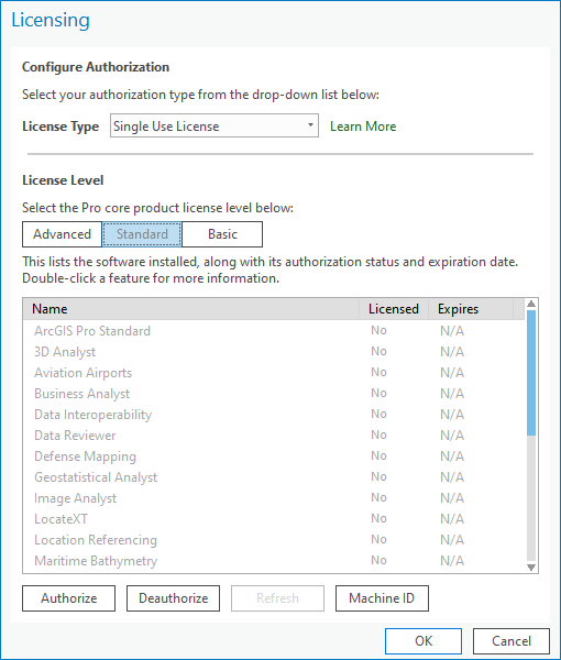

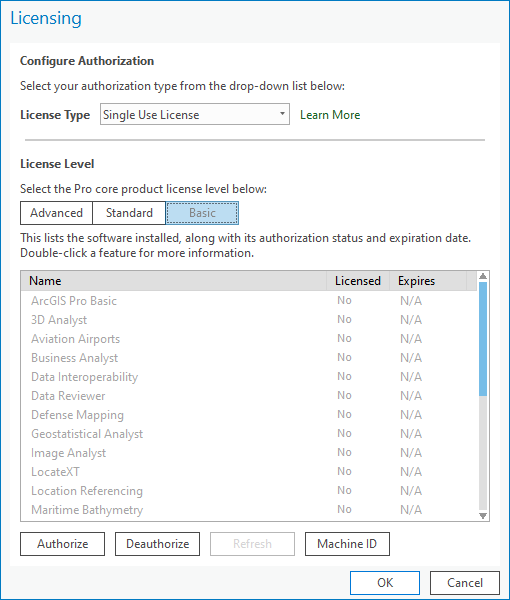

3.  Go back to ArcGIS Pro in Single Use licensing mode and click on the Deauthorize option.  You will eventually get to a window pane that list all the authorized licenses you can deauthorize.  What is the name of the feature(s)?  ArcGIS Pro licenses should have "Pro" in the feature name such as "ArcGIS Pro Advanced" for Pro Advanced core license.  If the feature you have does not have Pro in the feature name, it's likely a license for ArcMap.  You may have authorized with an authorization number for ArcMap.  Licenses for ArcMap cannot be used for ArcGIS Pro and vice versa.

Thanks for your reply! I solved my problem.
The problem is Google login issue. It is caused by my VPN.
I tried all process with VPN, that's the problem.
Thanks again your relply!
