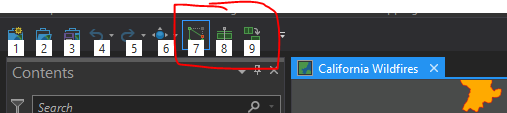

2. You can add editing tools to your Quick Access Toolbar and then use built-in Accessibility to get to access keys using Alt: Use ArcGIS Pro with a keyboard—ArcGIS Pro | ArcGIS Desktop
So above I could use Alt+7 to activate Vertices, Alt+8 to Split and Alt+9 to Merge.
