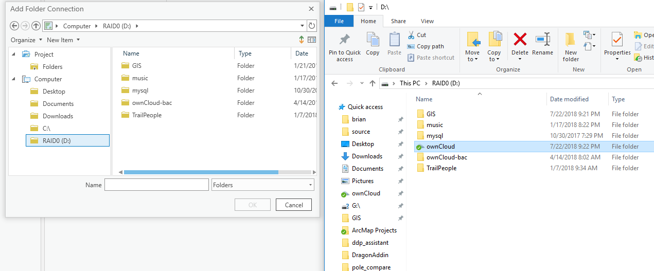

I saved an MXD in ArcMap, then went to import it in ArcGIS Pro, and AGP cannot see the folder I used at all. I thought the problem might be in "Import" so I tried other file dialogs. Same thing. ArcMap + ArcCatalog = work, ArcGIS Pro = fail.
Since I saved only a minute ago from ArcMap, I know it's not a permissions problem.
Here is a screenshot of the AGP "Add Folder Connection" window on the left and an Explorer window on the right.
Screenshot
Owncloud is a sync program like DropBox. It works flawlessly with all other software I use including QGIS 3. I use it extensively to manage and back up my data.

Workaround: Run a cmd window as administrator then create a symlink.
mklink /D d:\owncloud-AGP d:\owncloud
From AGP I can now access the folder under the symlink name d:\owncloud-AGP.

I'm going to venture a guess that Pro, by design, will not recognize 3rd party "cloud" storage Windows Explorer extensions. As a workaround, try making that "cloud" folder it's own drive letter.

I successfully did this in the past when Pro failed to recognize Google Drive or Box folders, but those now appear when searching a directory. I would recommend mapping your 'folder' to a drive letter as well.

It's really not 11 steps either, it's 2 so both methods fail and both are easy
1) Launch a command window by typing: cmd
2) Type: subst o: d:\owncloud
and finally undoing it (since it does not work) is subst o: /D
BrianWilson
Great suggestion but it does not work. I copied the MXD out of owncloud so I could try it. The MXD import worked fine this way. I am currently only running AGP on this one machine so this will do for now.
