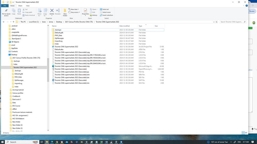

Hello,
I'm trying to export my shapefile which consists of geocoded points, but it seems to be missing the .dbf file. I geocoded stores from a .CSV file which I imported into ArcGIS pro.
Not sure what I'm doing wrong, as I made sure I had saved it as a .shp.
I've attached a screenshot of what was created.
Within my project there is also a CMA boundary file and world topographic map.
Thanks
Luke_Pinner
MVP Regular Contributor
It's there (3824 KB), but you have the "Hide extensions for known file types" option enabled in Windows Explorer. Go to the 3 dot menu, Options, View tab and disable it.
