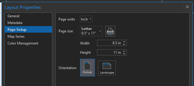

Layout properties showing page size.

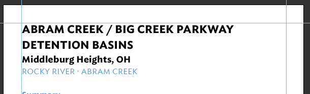

Guides in layout view showing top margin.

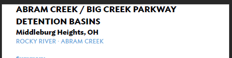

PDF Export - top margin removed

Do you have clip to graphics extent check on in your export? That clips to the graphic boundary and removes any margins. I can't think of any other reason this would be happening.

ChristinaNeal
That was exactly the cause. I must have accidentally selected that and did not notice. Thank you for your time!
