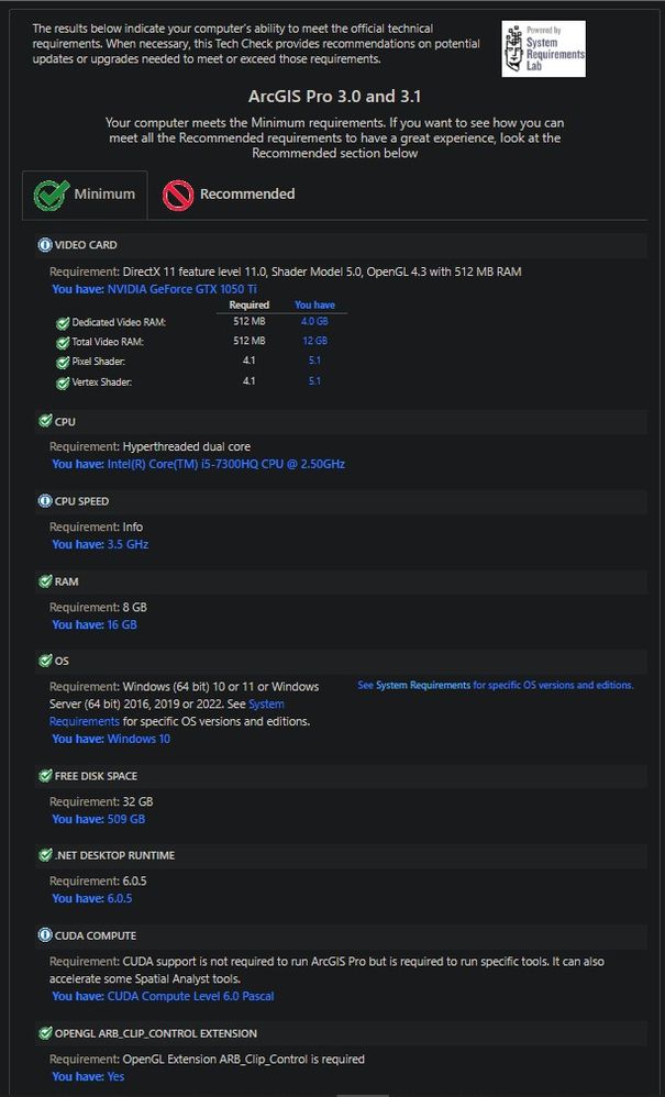

sigarwang
Tests showed that my computer was configured well enough to run arcgis, but it still showed a lack of disk space, and I wondered if it had only checked the C drive during installation.Snipaste_2023-05-05_15-31-59.jpg
DanPatterson
MVP Esteemed Contributor
it only checks the disk that Pro is installed on, so you will have to clean up any other disk yourself, especially if you use it for temp files
