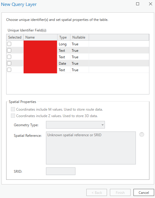

I have two mirroring deployments (Dev & Prod) of postgres with postgis extsnsion (i.e. not esri enterprise geodatabase) on AWS rd servers . The database on Prod was accidently deleted and then restored from old backup files each taken for individual schemas. Now, when I drag the database tables as query layers to ArcGIS Pro, it doesn't recognise the spatial properties despite having geom column. Instead it gets added to TOC as standalone table:
I got in contact with Esri tech support and by comparing Dev instance that's still working normally to Prod instance, they suggested that the login/user connecting to the database on Prod doesn't have enough permissions on the database objects (db, schema, extension, functions, etc) to that on Dev. However, when I gave that user access to all items to replicate Dev setup, ArcGIS Pro still doesn't recognise spatial properties.
Some troubleshooting steps I did before esri's involvment was to make sure geom column is existing, SRID is existing.
Any idea on what I can check to view data spatially from Prod?

Not sure if this is relevant, but are you able to connect to the db as the original schema owner (i.e. using the same user name as schema, not the 'owner' that is potentially different than the schema name) and does it behave the same as the user/role you are trying to grant permissions to?
Did you restore the schema and objects under a different schema name, possibly done by editing the logical backup's SQL commands if you used pg_dump for backup?

Yes, I have a username called "geouser" and there is a schema in the database called "geouser". I can connect to the db using this user. However, the schemas having the geospatial data are different, which is the same set up in Dev. Also, "geouser" became the owner of the (db, public schema, geouser schema, spatial-ref_sys table in public schema and more).
Our IT did the restore, I'm not sure if they followed a specific order or workflow.
Worth mentioning that I can connect to this db from QGIS and open the data normally

I had a similar issue happen with some layers in my organization's PostgreSQL+PostGIS database. Make sure your layers have a spatial index assigned to their geom.
QGIS, which is what we use internally, auto-assigns a primary ID and spatial index. However, when testing our partner agency connections through ArcGIS Pro, I ran into the same prompt as your screenshot. Turns out some of our database layers did not have a primary key set, nor a spatial index on their geom. Once I ran the SQL commands to assign these, the issue was resolved. This also lessened the loading time for a layer in arc pro.
