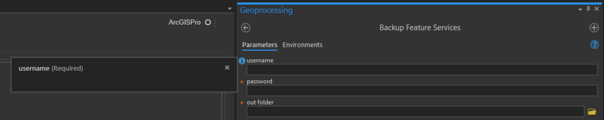

 I've created a custom script tool. And I want to be able to describe what to do for each parameter. I would think you could edit the little info box that appears when you hover over it. Right now it's blank.

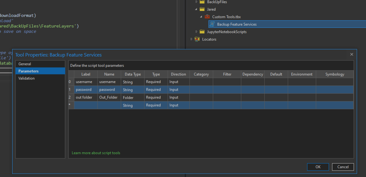

I don't see anywhere in the Tool Properties> Parameters where you could do this.

I think if you right-click on the script tool and 'edit metadata' then the 'Syntax' box is the little icon text.

That's it, thanks! You can't forget to save in the Metadata tab to keep your changes, I noticed.
