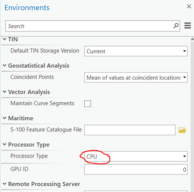

JayantaPoddar
MVP Alum
Although I haven't tested this, could you give it a try?
In ArcGIS Pro > Analysis Tab > Environments (Geoprocessing) > Scroll down to "Processing Type" and change it to 'CPU'. Does it make any difference?
Think Location
EgorNozdrya
Thank you  Jayanta,
  Though - It looks like this option only available for geoprocessing, not for animation export/rendering
  I've set it to CPU- but Arc still using GPU before giving up - screenshot attached
  There got to be another place to choose software vs hardware animation frame rendering (I only see option DirectX vs OpenGL in the settings, not the hardware acceleration switch)
Trying to export it on laptop with different nVidia card behaves different, but also randomly lock up during export. Exported animation frames have different set of glitches, so I guess all that related to nVidia drivers and handled outside of Arc. With no option to turn on software-based rendering.
