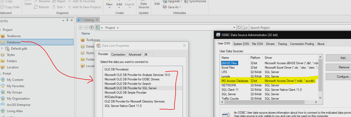

  Looking at my ODBC Data Connections on my system, I see that in both the 32-Bit and 64-Bit have the MS Access Database listed for *.mdb and *.accdb.
However in Pro, I still do not see any reference to any Microsoft Office 12.0 Access Database which from (https://support.esri.com/en/technical-article/000024144 )I should be seeing.

  Yes this is what I have been doing.  We're using the 32-Bit MS Office 365 here.  I can't use the 64-bit because after installing it, Access fails to open, so I had to remove it each time I tested the 64-bit Microsoft engine.  The 32-bit one allows Access to open, but I do not see as shown above, any of the Microsoft Database Engine options in the ODBC Database Connect.

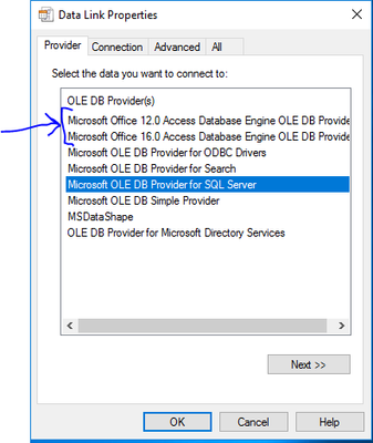

5) You should now see the MS Office 12.0 and 16.0 Access Database Engine OLE providers listed.  I did not need to do a restart.

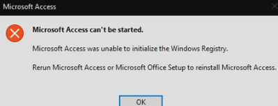

See that's what I've been doing and I'm unable to see that.  I've been doing both on the C drive via quiet mode.  I haven't tried it in /passive at all, but heard that wasn't the best way.  The biggest issue as I mentioned, is when doing the x64 it then prevents Access itself from opening up and causes an error.  This is where I'm at a loss.  So it seems maybe something else is going on in the background then if you can get it to work and I am not able to see that.
I just tried it again and for some reason I was able to see the MS Office 12.0 and 16.0 now.  However, the issue is the same that when installing the 64-bit, I can no longer open access.  Using the 32-bit one I am, but then I can't see the MS Office 12 or 16 in Pro:

You are absolutely correct.  I also cannot open the 32-bit version of Access if the 64-bit version of Microsoft Access Database Engine 2016 Redistributable is installed.
Since you are using Office 365 you should be able to download and install the 64-bit version of office this may eliminate the compatibility issue.  I do not have access to a 64-bit version until this evening to confirm if you can still open Access with the 64-bit version of Microsoft Access Database Engine 2016 Redistributable installed but will check it out tonight.  I know the drivers were showing but I did not try to open Access.
