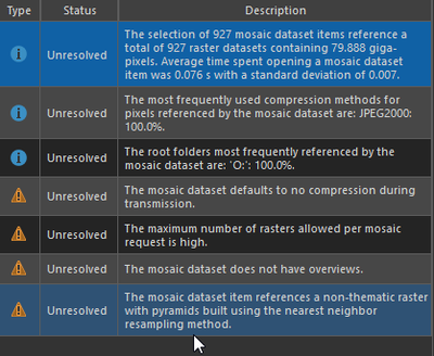

I just ran the tool with all options checked and got these results:
What is strange is that the dataset DOES have overviews. I ran the tool to create them and the folder with all of the images has tons of .OVR files.

Something must be wrong because I have run that tool (multiple times, in fact) and it doesn't appear to have worked. See my screenshot above. The analysis says that it does not have overviews even though I have run that tool.

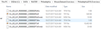

Does your mosaic dataset reside in a File Geodatabase?  If it does, another folder in the directory where the FGD resides will be created with the same name as the File Geodatabase, but with the extension .Overviews.
Within this folder should be the name of the Mosaic Dataset with a .Overviews extension.  Within that folder will be the TIF files:
Are these being generated?
MDB_GIS
Interesting. It does not exist. Here is the directory.

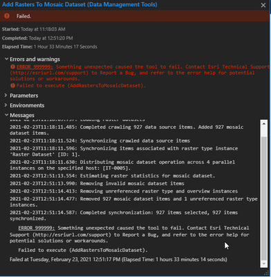

Ok, so I just tried the process again from scratch. I created an empty mosaic dataset using the 'Create Mosaic Dataset' tool. I then ran the 'Add Rasters to Mosaic Dataset' tool. It ran for 1 hour and 33 minutes and at 99% completion, the following error message popped up.
