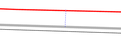

I have directional road linework. Conflation refuses to transfer attribution to both linework features...only the closest even though both are clearly within the search distance. Fat grey is Source. Red & thin black are Targets. The black Target is the one that received the attributes. The red received none. My search distance is 100' and the greatest distance from the Source to target missed is <50'. My entire state network shows this issue. Conflation seems to 'stop' for an area once is finds the first match. Suggestions? Thanks all. Greatly appreciated.
Spatial join is too messy in the metro areas with all the crossing highways & ramps. The results are too invalid.

It sounds like you have a centerline (the grey line) against dual-lines situation. Our Transfer Attributes tool currently only transfers to one side of the dual-line. We are aware of this shortcoming and are trying to address that in a future release along with some other enhancements.

Thank you for your speedy response. You are correct - Source dataset is single line & Target dataset is double.

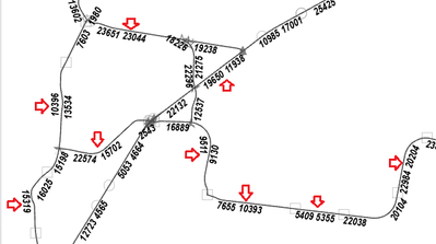

Thanks for the sample data.  I found that your source data has many relatively short lines. Below is the upper left corner of the source data. Do you know why they are not merged into longer lines?

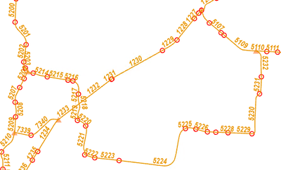

I also found that your target data has many overlapping or duplicate lines. That really makes feature matching difficult.  Are they intended this way? Here is the upper left corner of your target data; you can tell where overlapping features are by the double labels:

1: Short lines are correct. This is highway data and is split for several reasons/attributes, e.g. change of speed, functional classification, traffic count, etc. No way around this.
2: Overlapping linework is correct. This indicates directional traffic. Transportation software (INRO EMME, PTV VISUM) manages transportation networks this way. Directionality of linework drawn indicates direction when exported out of the transportation software (in the transportation software it is depicted by a From Node -> To Node). No way around this.
