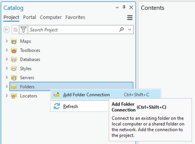

I have been having this problem for weeks!!! and i have simply ran out of soulations, even being in touch with ESRI hasnt helped me at all. My arcgis pro stopped connection to the windows folder, which means i have to always drag in the folder i want to connect as a workaround but this is a nuisance because when i want to publish a map using my server, it affects this and i havent figured any workaround this solution. Everytime i try to connect to the folder or open it using my arcgis pro it freezes the screen. I have tried using one screen and multiple same issue. I have tried deleting the program, and upgrading same issue. WHY?

Hello @Pamela  it sounds like you are trying to use Add Folder Connection from ArcGIS Pro's Catalog view - is that correct ?
If so, where is the Folder you are trying to connect to ? If you are not using a simple local location, eg C:\MyFolder, then please try that as a test.

Hi, yes i have previously added folder connections without any type of problem. When i press the button to add that, the screen freezes without any folder showing up. I have to press ESC to escape to use the screen again. Its very odd but has been ongoing for weeks now. I am now using version 3.1 och i was using 3.0 before

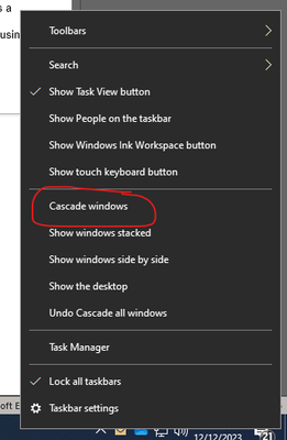

or try right-clicking your toolbar and clicking on  Cascade Windows. Just a guess. That way you don't have to mess with screen settings.

Thank you so much! This solved the problem 🙂
