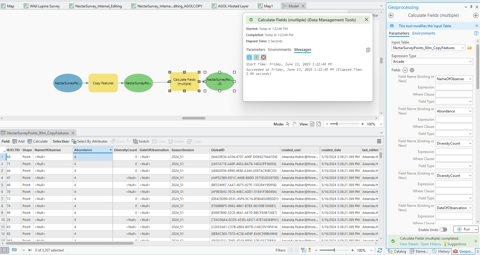

Has anyone else seen issues when using the Calculate Fields (Multiple) tool, to calculate fields to NULL. I have tested using both Arcade and Python and the tool says it executes successful, but when viewing the data all the records are still there and are not NULL
Any insight into this would be appreciated.

I tested RPGIS's suggestion with the expression being Null if arcade and None if python in ModelBuilder as you had in your graphic.  Works as expected.  Add Null or None to your expression parameter and it should work.
