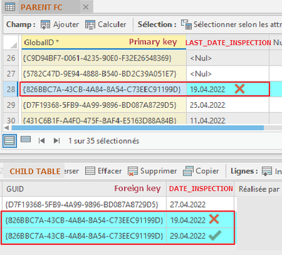

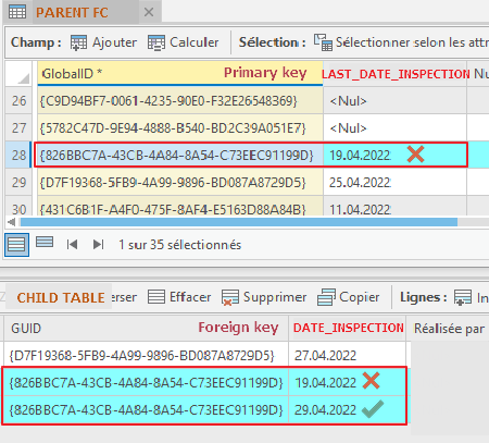

I have an ArcGIS geodatabase with a parent feature class related to a child stand alone table containing the various inspections made on each parent feature. Primary key is GlobalID and foreign key is GUID.
In ArcGIS Pro, I'm trying to edit an attribute rule to automatically populate a LAST_DATE_INSPECTION field in the parent feature class with the most recent inspection (DATE_INSPECTION field in the child table).
The code I did is only updating the parent LAST_DATE_INSPECTION field with the first inserted inspection date of the child table, not the most recent date. Looks like my filter isn't working.

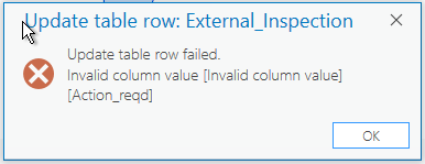

I'm looking to replicate this but for a simple Yes/No attribute field called 'Action_reqd'. All steps seem to be working and the code validates fine, however when updating a child record, I'm getting the "Update table row failed. Invalid column value [Invalid column value] [Action_reqd]"
I'm not sure how to resolve - any pointers gratefully recevived 🙂
