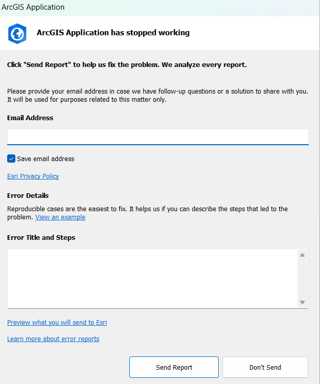

When I'm working in the application and go to the layouts section, even making a minimal edit causes the application to stop and stop working. I get the following error. I’ve tried uninstalling and reinstalling, but it still doesn’t work. I can’t create layouts because the application crashes, and I don’t know what to do. Could you please help me with my problem? Thank you very much.

If you are on 3.4: please try switching to DirectX11 in Options-Display and see if that resolves the issue.  We received some error reports recently that indicated an issue in resource management on layouts only in DirectX12 (which is the default in Pro 3.4), so switching to DirectX11 should work around the issue if this is what you are experiencing.

I will now provide more details about my issue, and to do so, I will give you some context about my setup:
  • I am working on a laptop with an i5 13th-gen CPU, a 4050 GPU with 8GB, 16GB DDR5 RAM, and Windows 11.
  • I recently installed the program on this laptop. I’ve had it for a year, but I just started using ArcGIS.
  • All the laptop's drivers are updated to the latest versions.
  • I am working on the files locally, stored on the laptop’s internal 1TB SSD.
  • I am not using any add-ins.
  • The error occurs in any project, even in new ones.
  • I am using ArcGIS Pro version 3.4. I also tried versions 3.3 and 3.1, and I get the same error in all of them when working on layouts. Now I’ve noticed that it’s not just layouts; it also happens frequently when I do multiple scrolls in a row.
  • I’ve already tried switching the DirectX version from 12 to 11 and to OpenGL, but I get the same error with all of them.
  • I’ve tested various combinations of the display settings, but the error persists.
  • I’ve tried running the program as an administrator.
  • I’ve also tried disconnecting peripherals, but the error still occurs.
  • I found a very old version, 2.7. The error took a bit longer to appear, but it still happened.

Probably the best thing to do would be to make sure your contact info is in the error report form, so that someone from development can reach out directly.  You can also contact support DIRECTLY and send them the DMP file so we can be sure to get it assigned to the correct team which is attributed to the faulting code area.
