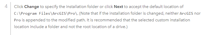

I'm glad you've got things running, Fred.  Did you have Pro installed directly on 😧 or was there a folder/path in which it was installed?
Download and install—ArcGIS Pro | ArcGIS Desktop
Please let me know so that we can take a look at this behavior and determine if there is something that might be improved.

AmarDjaouti
Hi everybody,
I'm working with Fred on the production of mmpk file.
If I remember correctly (We've deleted Pro on D:\ in order to install it again on C:\), ArcGIS Pro was installed directly on D:\.
So our path to the conda environment was :
D:\ArcGISPro\bin\Python\envs\arcgispro-py3
instead of :
C:\Program Files\ArcGIS\Pro\bin\Python\envs\arcgispro-py3
as it is now.
