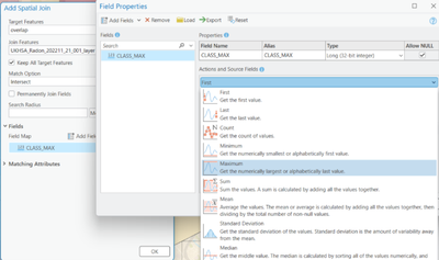

ESRI UK Support were able to resolve this for me. Thank you!
Use Add Spatial Join

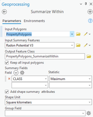

if both inputs are polygons, then a summarize within using the maximum might work
Summarize Within (Analysis)—ArcGIS Pro | Documentation

I had a go with Summarize Within Tool but the output generated some odd results.
As the coloured Polygons only contain values in a field named CLASS of either 1,2,3,4,5 or 6 I would expect the Maximum statistic to return a whole value.
In quite a few cases I am getting decimal points.
and in the highlighted record above the value should actually be 4.
Unsure if I am missing something?

From the help topic
Polygon summary features are summarized using the areal proportions of the input features.
So it has portioned the max based on the areal overlap.
If the inputs were rasters, then a "zonal maximum" would be what you are after.
