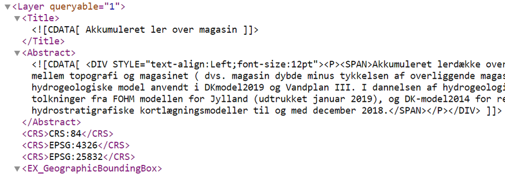

cbp-geus
We are also encounting this problem and haven't found a way to remove it. It's a problematic issue that is causing a mess in the GetCapabilities info of the hosted service.
<Abstract>
<![CDATA[ <DIV STYLE="text-align:Left;font-size:12pt"><P><SPAN>

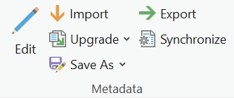

We have found an workaround for this issue which is unfortunately time consuming as every layer has to be updated with this method.
The workaround is to select the affected map or layer in the Catalog View and do an Export of the metadata to an xml file. We used the FGDC CSDGM format. Then do an Import for the same affected map / layer with the exported file and republish the service.
After this we could confirm that the issue with the HTML TAG disappeared from the map service.
