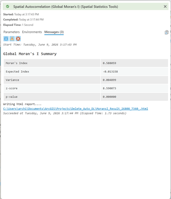

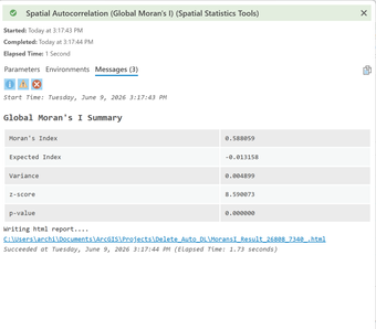

ArchitSrivastava
Hi @GlenterpriseUK,
Thank you for the suggestion.
I first tried running the Buffer tool, but since it does not generate much detailed messaging, it was not the best comparison for this issue.
I then tested another non-deep-learning geoprocessing tool, Spatial Autocorrelation (Global Moran’s I), because it produces a more detailed Messages output. After restarting ArcGIS Pro, the Messages tab for that tool still retained the results, including the Moran’s I summary, z-score, p-value, and output HTML report path.
Screenshot Before Restart
Screenshot After Restart
From this quick test, it looks like the issue may not be happening with every geoprocessing tool. So far, I have only noticed it with the deep learning tools I mentioned earlier, but I have not tested every tool category yet.

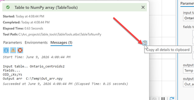

DanPatterson
MVP Esteemed Contributor
As a precaution, in case it is a bug, you can always copy the results of any current run to the clipboard.
