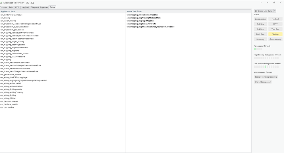

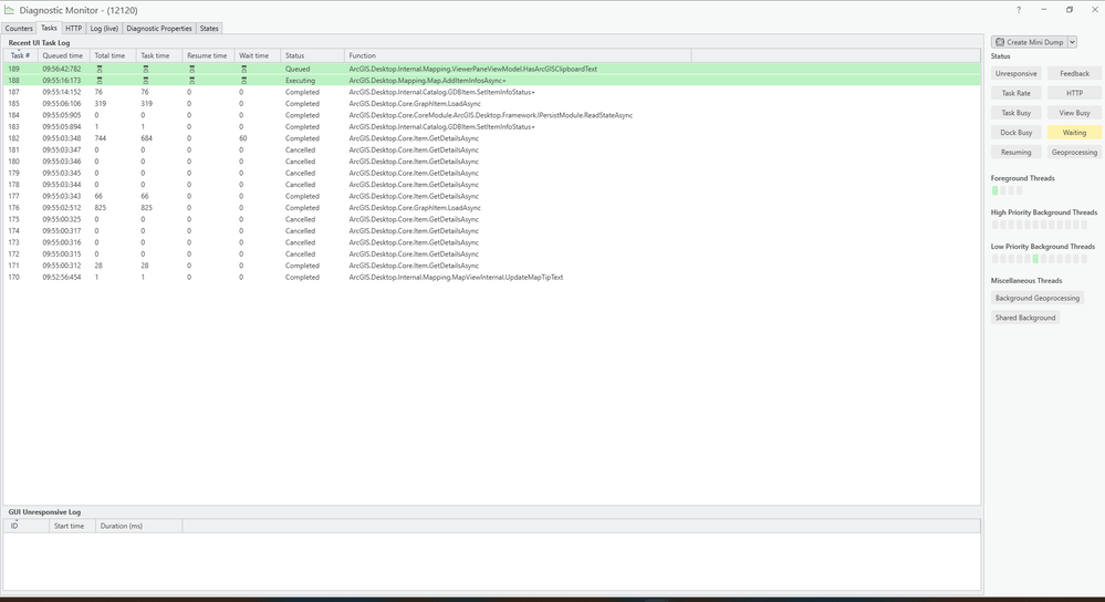

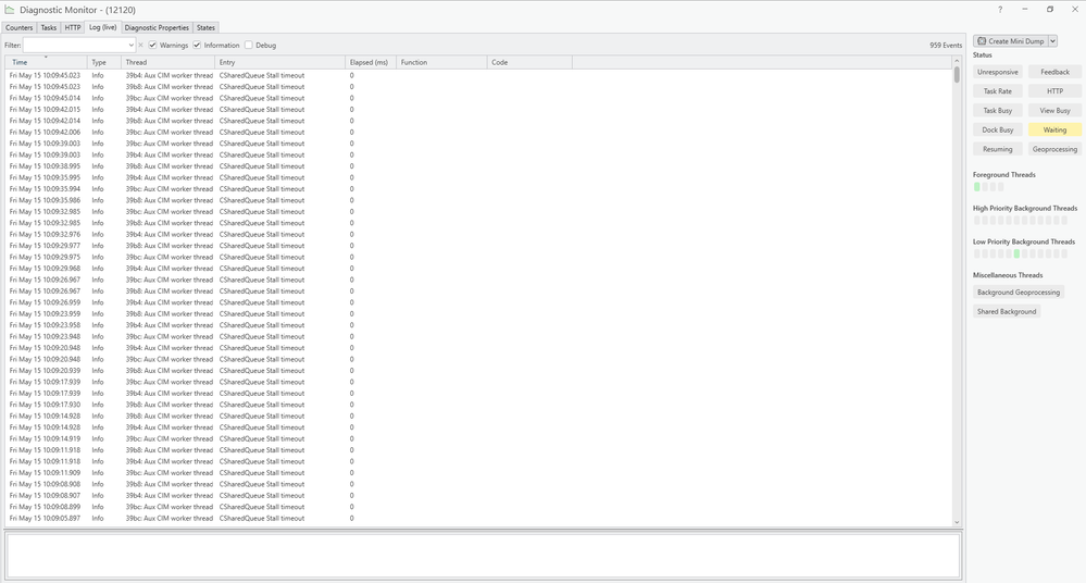

I did start a new blank map and had the stalling issue on this computer with a different Windows 11 login other than the original user with the problem.   The only data in the map are the default world topo and hillshade.   The software stalled but now errors were showing in the Diagnostic Manager.  I did add a file geodatabase feature class and the Diagnostic monitor shows this issue:
<Event time="Fri May 15 9:56:38.062" type="Info" thread="39b8: Aux CIM worker thread" elapsed="0" function="" code="">
CSharedQueue Stall timeout
</Event>
Here is a web search return for this error:  https://support.esri.com/en-us/bug/arcgis-pro-becomes-unresponsive-upon-opening-attribute-bug-000181...
