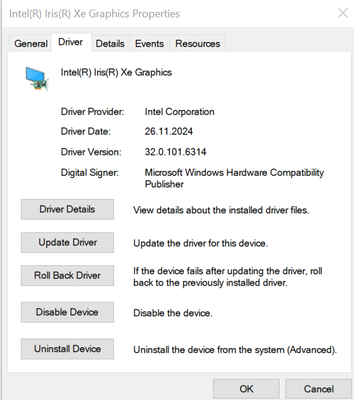

One quick update from my side: It looks like it was just a temporary fix. Yesterday, when I worked in ArcGIS Pro, the issue came back, so I switched to DirectX11, and it looks like it's good now.
Below are the details of my driver:

Sara,
I spent some time attempting to replicate your results on my Intel Iris Xe laptop but was unable to with the 9/24 or 12/10 driver.
When you look in device manager under display adapters, and open the Intel Xe, what version is showing on the driver tab? (the full number)
