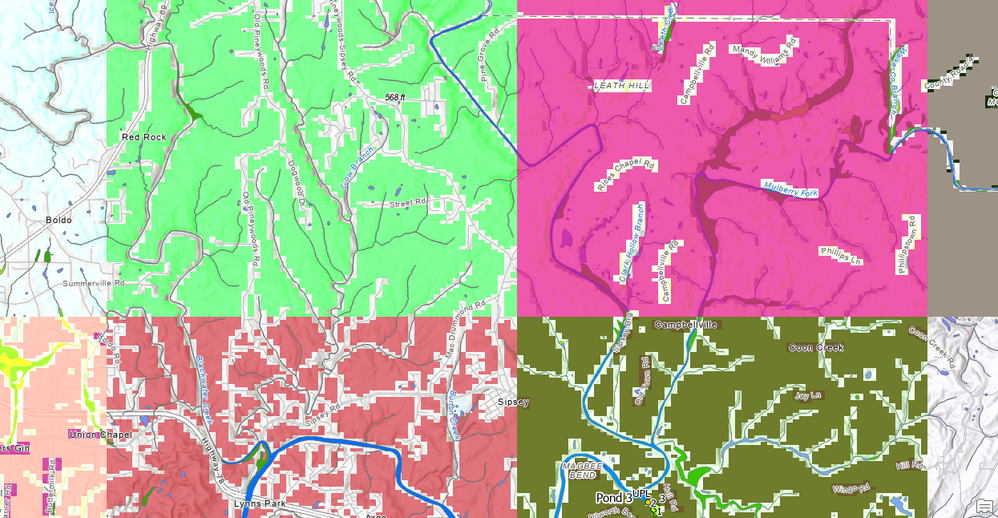

I'm having an issue in 3.4.0 where ArcPro is creating weird artifacts in multiple unique Projects. Take a look:
The 2nd image shows that it's creating these artifacts around the basemap as well-- not just the features I'm using.
This issue doesn't exist outside of ArcPro, leading me to think it's not a PC issue, such as a bad graphics card.
No idea what's happening, preventing me from asking intelligent questions.

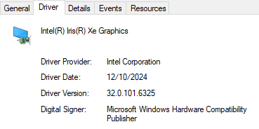

Hi @JeremyWright, my driver version is 32.0.101.6325. I have been using DirectX 11 for the past month which has been an effective work-around. But I switched back to DirectX 12 now just to test it again, and as you can see, the problem persists for me under that rendering engine.
JeremyWright
thanks Sara.  I'll include this in our report to Intel to let them know that this is still reproducible for some users even on the latest driver + DirectX12

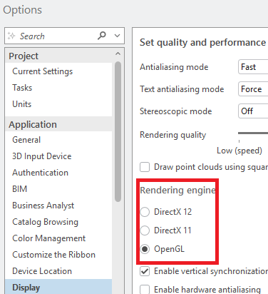

I would also like to chime in with how easy it is to switch to DirectX 11 or OpenGL. Reading through this thread made me think that I needed to install something new, because I forgot about the Display options from within Pro. So - while it may be better to fix up your actual drivers - in a pinch, just switching what you use worked for me. This is probably obvious to everyone on this thread, but in the interest of helping out folks who come here from Google:
JeremyWright
So just to be clear here this is a bug in the Intel driver itself.  Unfortunately on my Iris Xe machine I can't repro the problem.  @Minsley @rwygmans can you folks let us know what OS version you're running? you can run the command WinVer from start->Run to get this info.
In the meantime, you can work around this by switching to DirectX11 in the display options for Pro.

ArcGIS Pro 3.4 change the default driver from DirectX 11 to DirectX 12. Ways to resolve are to (1) ensure you have the newest DirectX 12 graphics driver, (2) change default back to DirectX 11, or (3) change default to OpenGL. Graphic card options can be set in Pro's options->display tab.
