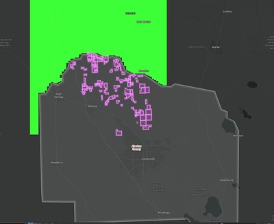

I'm having an issue in 3.4.0 where ArcPro is creating weird artifacts in multiple unique Projects. Take a look:

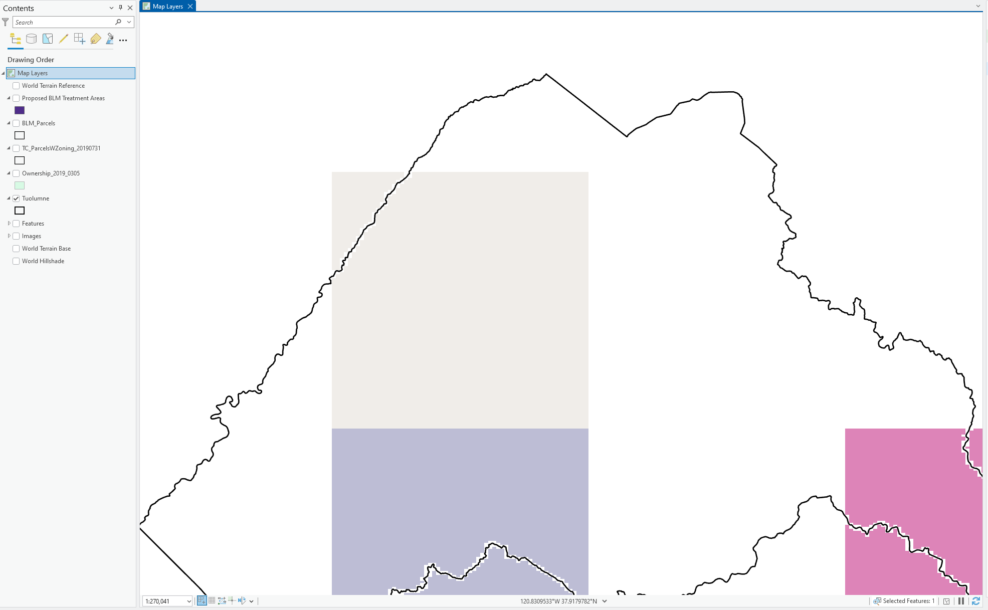

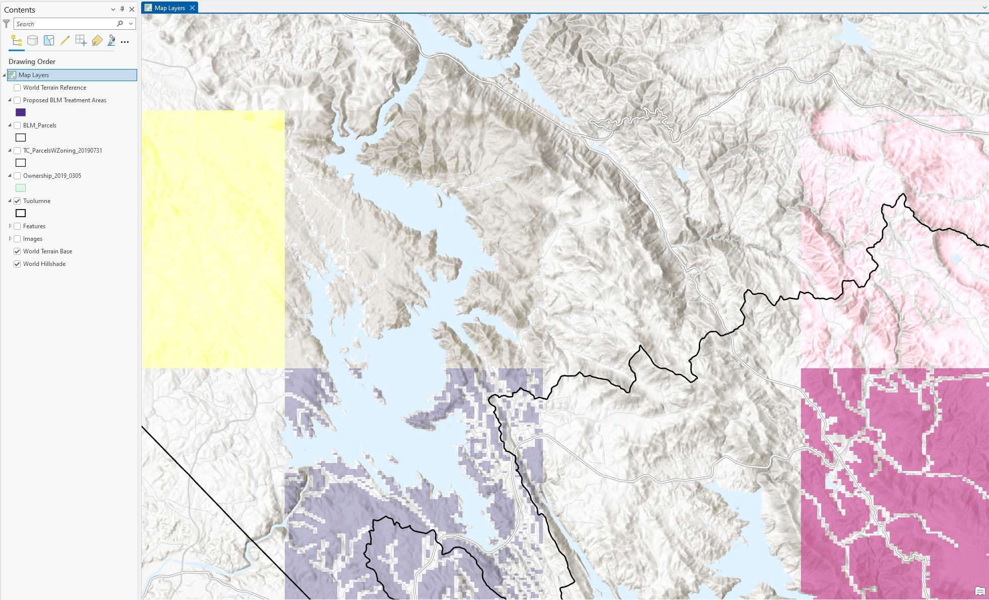

The 2nd image shows that it's creating these artifacts around the basemap as well-- not just the features I'm using.

Hi, we've seen this visual artifact in the past with older drivers, especially with Intel GPUs, when using DirectX 12.  We confirmed with Intel that later versions of the drivers fixed the artifacts.
Please let us know what is listed under \display adapters in Device manager and what date/version the driver shows in its properties.
To try and work around it, switch to DirectX 11 or OpenGL in Pro's options->display tab.

I'm having this same issue, Random color blocks that cover whole sections of my maps, with "holes" where labels are.

OK yep, I have same GPU in my daily driver laptop.  After we reported the issue to Intel, I had updated to september driver version and the problem went away.  Both Dell Support and the Intel Driver Support Assistant showed me the updated drivers, so you should just be able to tell your support department to update to the latest driver to resolve the problem.
