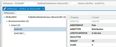

It seems the "Version Differences" tool (which is *really* valuable in ArcMap) is slow to un-usable in ArcGIS Pro.   At least in Pro 3.3.   Is this a known issues that has been improved in later versions?

Hmmm...in your graphic are you using a Utility Network and branch verisoning or are you using traditional versioning?
