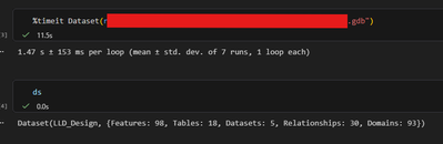

I have a Python toolbox that da.Walks out fileGDB template (~115 tables) and even on a local nvme drive with GB/s read speeds, it takes over a second to load. That's in headless too. The same code running in Pro takes 10+ seconds.
